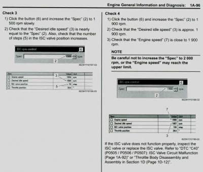

I wonder when the warning appears exactly ?
Says the upper limit is 2000rpm.

Thanks. Yes, I've seen that box to switch off ICS Valve in ECU Editor.
Maybe can be reset manually though with screw #17 without setting off the warning code, but to what extra rpm?
