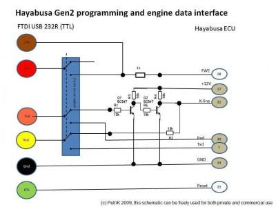

TRE = telling the ECU the bike is in 5h all of the time plug and play $100+
SMART TRE= telling the ecu the bike is in 5th all of the time EXCEPT for neutral thus giving a better idle plug and play $100+
Modded GPS(Gear Position Sensor)= modified gear position sensor that tells the ECU the bike the correct gear EXCEPT for 6h which it tells the ECU is 5th. You must remove the clutch hub to install
Boost By Smith DeRestrictor= same as Modded GPS but it is plug and play $26
Reflashing the ECU= the most EFFICIENT solution. Boost by Smith and some others sell the harness(or use the schematic above) or pay some one $30 to $100 to do it for you.
