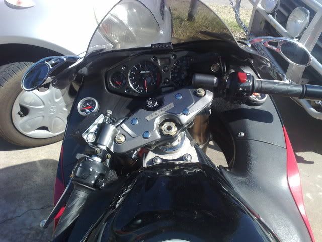

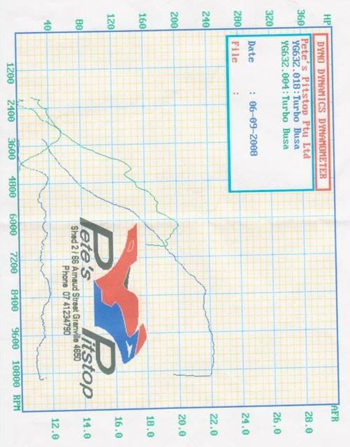

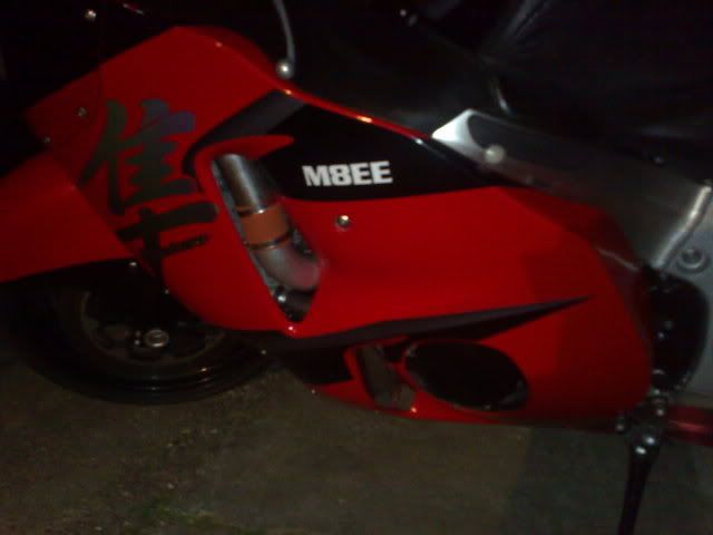

Turbo is on and tuned. 8Lb boost getting just under 250Hp on the dyno. Thanks to Greg (Maj) for the kit, Pete at Pete's pitstop for the tune and map, Shayne (Abusa) for the required extra bits - I still owe you a hundred too mate, and a special big thanks to Shane ( The Shredder ) for putting the whole thing together. Power is Eek I am happy as a 2 headed dog with 2 dicks, and can't wait to get to the strip.
Link to dyno run vid...

Well Done M8EE. Are you running stock engine comp?

thanx guys. Horndog - I have decompressed it. not sure what max boost is on stock comp.

thats awsome M8ee looks like a nice fit as well, i couldn't imagine the power difference....the front has to be light now?

That is an understatement - I got my first taste of full boost in 1st gear the other day - underpants blowing experience. By the time I worked out it was kicking in hard and rolled the boost off and got the front wheel back down, I had travelled to the other end of the street. It feels like you are just having a normal ride up the road, and a bit of time goes missing, then you are there. LOL.
Glen, I can't take any credit for the hard work, that was all done by shredder, maj and pete, but I'll let you know some numbers as soon as I get it on the strip. - As you say, having the power there is one thing, using it is a different kettle of fish.

horndog Wrote:Well Done M8EE. Are you running stock engine comp?
Anyone tell me whats the max safe boost for a stock compression engine?
There is no such thing as turbo and stock compression.It is a guarranted disaster..
When it comes to turbo you'll have to fit a lower compresion head gasket.The others can remain at stock.The compression no..
