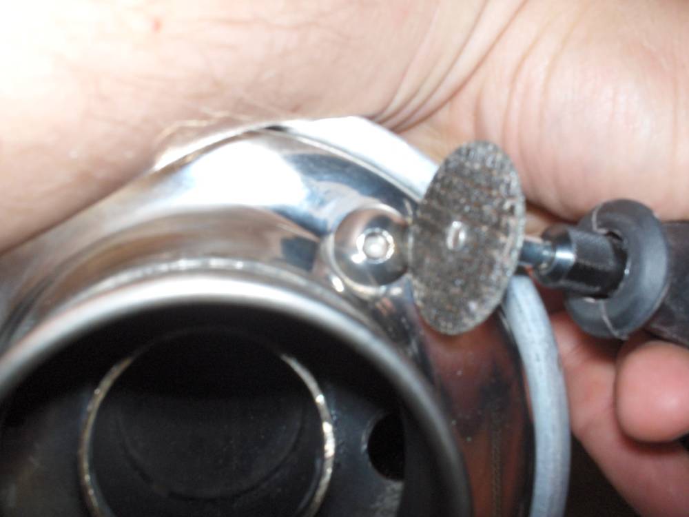

I used a dremel to cut the welds that hold the three allen screws in place on the endcaps. I removed the caps and drilled one half inch hole between the threaded rods for the cap mount, It wasn't loud enough so I added three more to each, I still have room for 3 more for a total of nine. With the first three there was some resonation with the cap back on so I cut 1.5 inches off of the center pipe. After cutting off that the resonation went away but it still wasn't very loud, so I drilled the second set of three holes.

STEP 1
Use a dremel or some sort of wheel and cut the welds that hold the allen buttonheads in place. Then use a 4mm allen wrench to remove the screws
