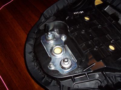

Ok, here ya go!
What the mechanism looks like.
Firstly find a thin wire coathanger and straighten it out.
You need to mark a straight section at a point 16cm from the tip.
This is how far in the latch is from the point where it first engages onto the wire.
Without this mark on the wire you won't be able to tell if you have contacted the latch properly and could take quite a while to find it without being able to see.
There is a point on the right side of the bike where the wire will go in between the hump and the rear cowling without the need to lever the hump up.
Get you hands on the wire and manouver it through the gap and at an angle that you can see in the photo. You need to keep the wire on a flat angle so that the point of the wire goes straight to the latch.
If you jiggle the wire when it gets to the 16cm mark, you should here it making contact with the latch, it gives a bit of a rattle.
If the wire is in contact with the latch, you can push straight in with the wire and it moves the latch across. If you get it right, the hump just pops up.
Good luck. I have done it a couple of times now and it gets easier each time you attempt it once you get it right.
Of course for anyone with the hump unlocked, you can make the wire and practice a few times before testing with the hump locked on.

For those who have inadvertantly locked their seat on without reconnecting the cable release rather than the hump, you will need to approach with a slightly different style but the procedure is much the same.
The seat has a guard around the latch to prevent getting at it from the right side of the bike. That is why Slade was unsuccsessful with my hump removal method.
See this photo. It shows the moulded latch hider. Click for larger view.
To defeat this obstacle, you need a piece of wire marked at a 20cm point with a 90 degree hook on the business end.
With this wire you come from the left side of the bike at the same angle as for the hump removal.
Point the hook end of the wire to the latch at the 20cm mark and wiggle it about. You clearly hear the latch rattle if you are in the correct location.
Once at that point simply push the hook around the latch and it will catch on the latch from the far side. Once it is hooked, simply pull back on the wire if you feel the spring loaded latch.
It will pop the seat up if you are hooked successfully.
Here is a photo of the hook wire that I made out of a coat hanger.
Remember to mark the wire at a point 20cm from the hook so you know how far in to poke it from the edge of the seat.
This procedure will enable access to the underside of a locked seat or hump. I would recommend not relying on that space for anything of real value and I only offer this solution as an emergency access process for owners who need to remove the hump or seat.
