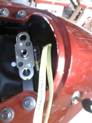

Need some help big time. I removed my rear fairing to replace a dead reg/rec , put it back on all good charging again BUT i f**kin forgot to put the cable back in to remove the hump with the key. I cant get if off now key just turns to no avail, any suggestions as to how i can get the hump off with no key to unlock it

Perhaps some plastic packing strap folded in half would get in there to hook on the lever to open it and not damage anything .

i actually cut a small hole can came in from under the rear... it sucked but worked.. use this as last resort.
RE: F**kin HELP!!!! - Heidi1 - 19-03-2008
I have tiny hands (for a guy), so I got a mate to try and hold the fairing apart and I wriggled my hand in there. I lost a lot of skin, but didn't have to drill. Dude, it is a mistake most of us have made ONCE.

I have done it, too - Balls got it off with a wire/strap by just lifting it that fraction and slipping the bugger in...

Watched Pete from Pete's Pitstop do it for me with a coat hanger.
If you know a Busa workshop up your way just pop in and they will do it in 10 secs.

I think it was Leonard that showed me he lifited the hump a bit then drilled a small hole in the tail on the edge where the hump sits (Not in the Hump it self) on the RHS near the back bolt then put in some strong piece of wire to pust to the lock open..
