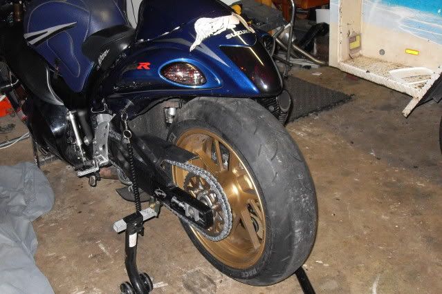

Is it looking like this
[Image: shifterrear2SDC10118.jpg]
I have about 2 inch clearance between the tyre & tail light area, I made up the number plate holder thats works as a skid plate as well
I have my compression & rebound hard as all the way clockwise
if you want my number PM me
K8 Stock motor, best ET 9.124

RE: Static sag?? - fasterfaster - 26-11-2009
His looks similiar to yours Simmo ................ but it's the much faster orange colour.
RE: Static sag?? - twistgrip - 26-11-2009
simmo,mine might be a touch lower.Originally i bought lowering links(with 3 holes) the longest hole is where i want the bike to sit (tail hits) & the middle hole is 2 high so i had a inbetween set made,i now have around 2" clearance,seems to sag abit when i sit on the bike so i'll check static this arv.I'm going to order a +6 tail early in the new year & get this baby on its guts!

RE: Static sag?? - simmo - 26-11-2009
(26-11-2009, 10:27am)twistgrip Wrote: simmo,mine might be a touch lower.Originally i bought lowering links(with 3 holes) the longest hole is where i want the bike to sit (tail hits) & the middle hole is 2 high so i had a inbetween set made,i now have around 2" clearance,seems to sag abit when i sit on the bike so i'll check static this arv.I'm going to order a +6 tail early in the new year & get this baby on its guts!
We have a T&T on fri nite so i'll see how it all pans out.
Pete, can't wait to run the bike with my new flash tune,appreciate ur professionalism, help & adviceTrophy
Thanks guys for ur replies,appreciate itPi_thumbsup
Cheers Peter
Mine is rock hard (adjusted the spring it has a good inch of thread there now) mine sits a bit lower that the pic, but the poor old shock is trying to work in a 2 inch area (they are not make for that) but you work with what you got
