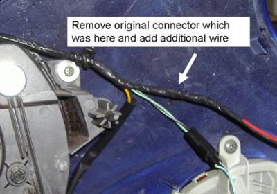

I extended the length of the auxiliary power lead (brown and black wires behind RHS front indicator light). This requires removing the nose fairing which is a bit fiddly but not too difficult. An alternative is to take the power from the wiring harness near the fuses on the LHS - this requires cutting the harness - not recommended but you don’t need to remove the nose cone.
1. Remove the nose cone (see bottom of this text)
2. Remove the original socket at the end of the accessory wire (brown and black wires) and attach the length of wire (either solder and tape or crimp). Do not just twist the wires together as it is a lot of work to repair a faulty connection!
3. Install the nose cone bringing the auxiliary wire back to the back of the black infill panel (either left or right side as required by you) beside the forks.
4. Trim the wire leaving enough to attach the female end of the two wire connector and to mount on the edge of the infill panel. Attach the female connector noting which pin is used for -ve. I filled the back with silicon just to make sure no moisture will ever get inside.
5. Drill a small hole at the rear of the infill panel inner lip and attach the Accessory wire to this with a cable tie. Allow enough wire so that the connector can be pushed back to lie on top of the inlet vent when not in use.
