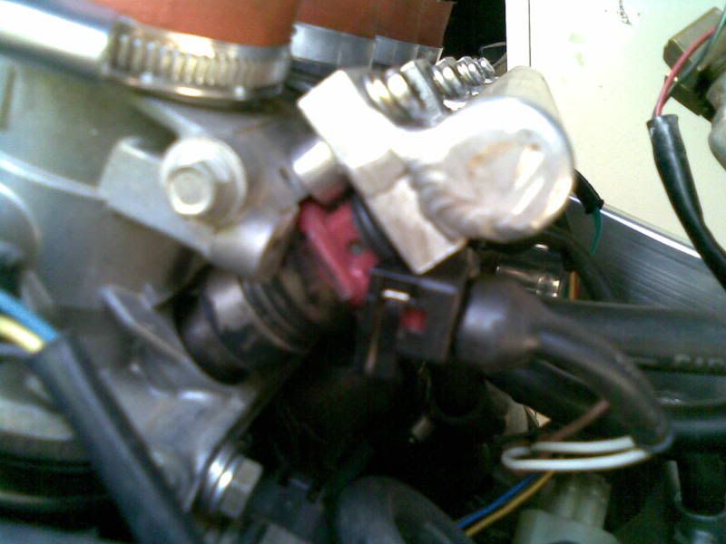

i have 550cc mazda injectors in my streetbike
Just be sure to get hi impedance
or you can use low imp, there is a resistor pack used in some cars that will allow you to run them
550cc in my bike
[Image: 20012009.jpg]

550cc cost me $100 on ebay and i cleaned & tested them myself ,
