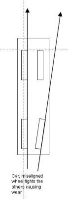

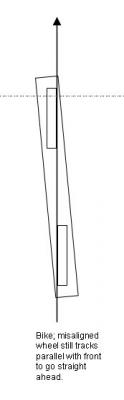

I dont understand how the rear wheel not being aligned will add to tyre wear. Irrespective of the rear wheel alignment - for the bike to go straight the wheels must be parallel (the bikes body may be going "sideways" though). Unlike a car when if the wheels are not aligned they fight against each other increasing wear.

The back wheel is the driving wheel and will tend to push the out of alignment front wheel sideways. In your picture you show both bike tyres tracking in the same direction. Out of alignment will have one straight and the other not on the same track. I'd love to know the physics behind the driving and driven wheel when the rear is pushing, and the front wheel being pushed out of parallel.

To go straight ahead both wheels need to point in the same direction but not necessarily in the same track.
The rider adjust for out of aligned rear wheels by automatically "re-aligning" the hadle bars. i noticed this when I had a HD that had an out of alignment rear wheel. On a long trip on the freeway I noticed the handle bars were a few degrees off straight (about 5) ahead even though the bike was going straight. Later investigation showed that the rear wheel was off alignment by quite a margin - fixed this and the handle bars were became straight.
By the way this is a good on the road test - if your bars are "straight" when your are going straight your rear is probably "reasonably" aligned. Note that I didn't feel the bars weren't straight, I compensated for it automatically - I had to see they were out of alignment.
re tyre wear. Thinking about it, if wheels were as in my picture I could see that the rear wheel would push the front a little to the left. In real situations the amount of out of alignment is much smaller than in my pic (a couple of degree at most). If I remember my vector diagrams I dont think the force would be so great to cause excessive wear, but if thats your experience I accept that.
Anyway, its great fun postulating. As I said Im not a mechanic etc. The point is the wheels should be aligned especially for chain and sprocket life and in your experience tyre life but its no drama if they are not "perfect"
